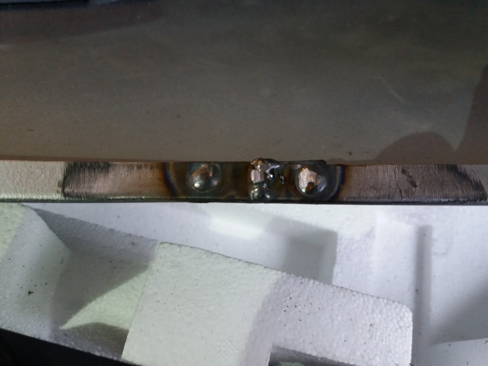

Thin metal with rust spot.
andz zed3
Feb 17, 2018
Tags
with plate clamped behind
drilled holes plug welded after clamping in place, and built up thin area in the center and after grinding it all back it was as new again
