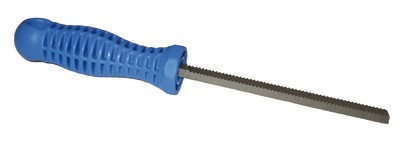

I use a brake file to clean the crud out of the pad slides. Brake files do not remove metal from the calliper just the soft corrosion. The front back plates often crack around the mounting screws and come loose and rattle.

Interesting. Can you link one of these said files matey?
I spent some good time with a grinder and wire wheel on mine. In places corrosion was quite thick so this file sounds useful.
Brake files do come in quite a range of prices. Such as Snap-On and Mac Tools are north of £30. This Sykes Pickavant one is worth looking at. In general cheaper ones do not last, they wear out (lose their "bite") quickly.
