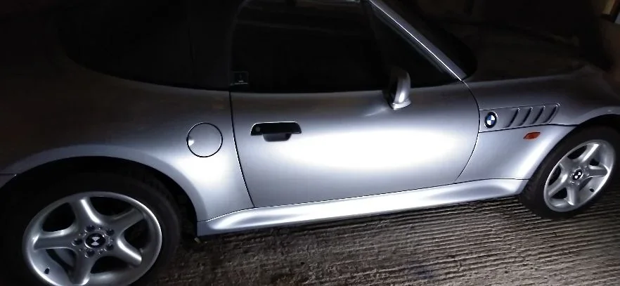

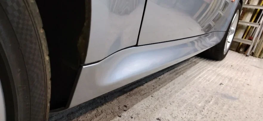

Well, it's been a while but the off side is now done, and I must say I am rather pleased with the results, especially as this is the first time I have got this involved with a project. It has to be said, this forum is a great place for ideas, help and inspiration, so thank you all. Not sure what's next, maybe a simple stereo swap. Roll on spring, and hopefully we can all get out and about, roof down and heated seats on of course.

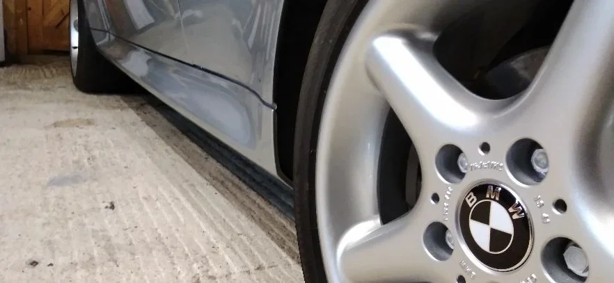

What are peoples thoughts on re-fitting freshly refurbed wheels. The reason for the question is, I was watching one oft the old episodes of "wheeler dealers", you know, the pukka one's with Edd, and I am sure he said to remember to take off the new powder coating around the the nut seating so that the wheel doesn't come loose later. Not sure myself so I thought I'd ask the question, also do people torque up their nuts :) or just give them a good wind on with the extension bar. Many thanks.

Always, always, always tighten wheel nuts/bolts to the correct torque figure. Take careful note if you watch tyre fitters using the impact wrench to "run up" the nuts or bolts who then use a torque wrench to "check" them. If the torque wrench doesn't move and merely clicks straight away then they are already over tightened. Complain to the management. Over tightened wheels can cause cracks in the mounting holes.

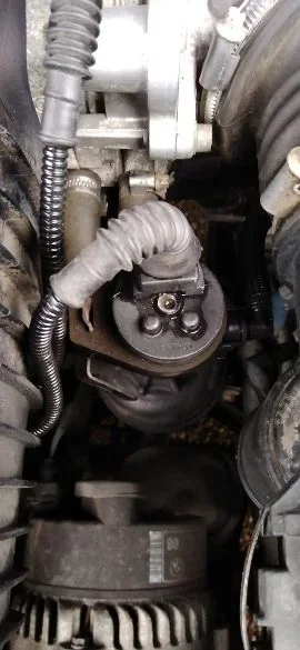

Hi all, could anyone tell me what this is and is it supposed to make a light plasticky ticking/knocking sound when the engine is on tick over. Just back from the MOT and barring a couple of roll bar bushes and rear brake pipes it was all good. While there I got them to do a service, first one in 10 years but it only did 9000 miles in that time so thought it was worth getting done. this cleaning bug is catching, first time i've cleaned an engine bay, bloody therapeutic though and even ordered some new chrome exhaust tips to keep up with you lot : )/

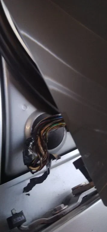

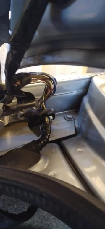

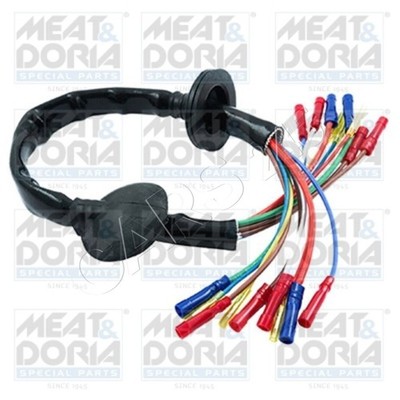

On a bit of a roll now. So ,The Loom of Doom, Any suggestions on what to do with this, Its the bunch of wires that run through near the boot hinge. Do I just tape it all up tight with insulation tape or is there a better alternative, Once again many thanks in advance.
Cheers.
Althulas
Jun 14, 2014
178
Banburyshire
M Roadster
If your wirings a bit ropey
There Might be cheaper options out there if you want to keep it oem looking otherwise some cloth or electrical tape will suffice.
That repair kit is a bit pricey but it is good, I have used it but I soldered the connections rather than crimped..

Thanks guys, It seems the wiring is in ok condition with no chaffing visible, so would it be ok to just re-wrap it with tape and then hook it back in the plastic clip carrier. Want to be sure, as there have been some nightmare stories on here with melted looms etc.
Cheers.
